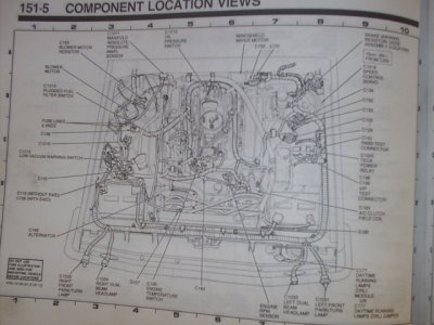

I'm trying to find out where it gets power from.
This may help, the fusible link goes back to the battery, probably connected to the side terminal of the starter solinoid. It is 20 amps, blue in body color with a yellow coded wire attached.
:hail you the man willie. :hail found the relay with the help of this pic and got it shifting alot better. still could use a little fine tuning.
you think you could help me out with a pic like this of the fuel sol. circuit? :thumbsup:
