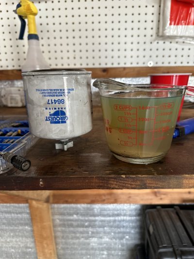

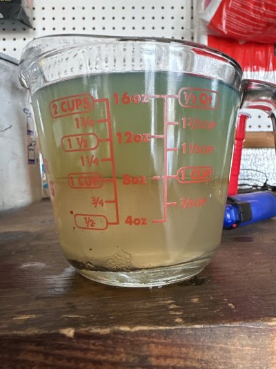

So I changed my fuel filter out today these were the results. Looks to me like there’s a lot of water there. Is this typical or should I?

That's a lot of water! 41 years of owning diesel pickups I've never seen that much from one filter draining.

Yea I’m new to the diesel industry but I couldn’t believe my eyes when I saw this. Bad fuel?
2,290
2,313
Could be bad fuel from a fuel station, or water got in your tank somehow. If I see any water in a separator, usually it's an ounce or two.

That is a bunch of water. Only time I see that much is if a person has gotten a bad fill up causing the truck to run rough. Did you change it for a reason or was it just time? How many months/miles were on it? Do you still have the filter vacuum light and is it operational?
IMO, buy 2 filters, install one and put the other in the cab as a backup. Then add a bottle of clear diesel from power service to the tank.

I know a lot of people hate them, but the 2 piece filters with the clear bowl are nice for this reason. You'd have seen the water plain as day when you opened the hood.

Yea the lift pump is bad I think. Truck stalls of deceleration. If allowed to come down slowly then truck stays at idle. I bought the truck last December. Hadn’t replaced the fuel filter yet so figured I’d try that first. Filled up with atf, drove it about 4 miles last night. Didn’t see improvement. Gonna replace lift pump today. Light comes on dash at start up, but is never on any other time so I would guess not.

Bummer. I didn't look to see if they were still available, I just remember finding and reading about them.
If it stalls while decelerating that'd typically be a sticking delivery valve, not a lift pump. I believe the atf has to sit in the injection pump overnight for it to have a shot at cleaning the pump. Most fill the filter, run the truck for 30 or so seconds, and then leave it sit overnight.
You can also run hot shots injector cleaner in the tank, or really any injector/pump cleaner, and do the same thing. Some need a few treated tanks to work. Some guys have luck with it, some haven't and replaced the pump to fix it.

If you use an additive that will disperse the water it will place the water in suspension in tiny droplets - untreated diesel fuel will leave the water on the bottom of the tank where you have a chance of draining the water out rather than the entire contents.

These trucks need better fuel filtration than what comes stock.
My 86 had the water separator on the Fire Wall that is prone to leak, Was all ready bypassed long before I bought the truck.
I replaced it with a Racor 500FG in it`s place with a 2 micron filter. Has a large Bowl on the bottom that can be drained.
I have used the smaller version, the 200FG on my Mercedes and Datsun Diesel 720. I have never had fuel problems, and had these things Diesels since 81.
That is a ton of water you drained out, never had anything like that. Like said, could have been from a fill up at a station, or some kid dumping water in the tank or???
You mentioned you just bought the truck, maybe it was there when you purchased it. Who know`s how long that Filter has been on the Engine.
