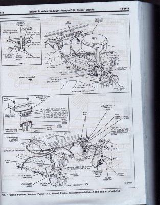

Thanks icanfixall. I think I am going to replace all of the vacuum lines since they all appear original. Only looks like 3 of them. One from Pump to T then one to the Brake Booster than one the air intake area (not sure what it is called on diesel) and one that seems to control the AC/Heat controls.
As of replying to this I went out to remove the Vac gauge I had set up and it still had 20hg vacuum on it. So it seems to be holding pretty good but not best imo.
