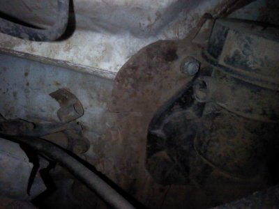

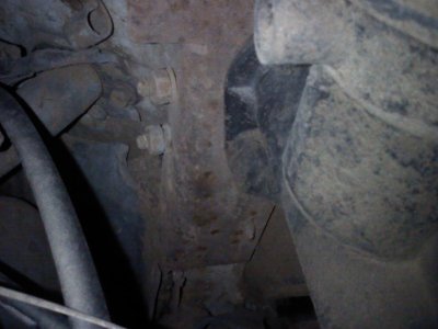

I will definitely be needing a large patch! I just picked up this 88 F350 CC 4x4, something tells me that patch was installed wrong!

yea it looks like it. once punkmechanic gets back to me (if someone has his number call him lol)
ill be cutting those as well
