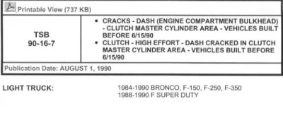

If you guys want to send me an email addy, via pm, I can email you a copy of the TSB for this problem. I believe it has a few pictures and will definetely help with the install.

I've seen the TSB in the FAQ section... that's the AllData one, right?
It doesn't build a very good picture in my head though. I'd like to be able to identify one in the junkyard. It's a plate, correct? Does it get installed under the dash, or outside on the firewall?
Do you happen to have a photograph of one of these suckers installed?
I'm gonna take another stab reading that thing. Maybe if I actually read the instructions, it'll make more sense.

Done quite a few myself, but it has been a few years. Mine was the worst I have ever seen, mainly because of two things, one, the po tried to weld the crappy metal and two, he didn't do anything else to fix the problem, just kept driving it.
You may not see the cracks, but if you have any movement, don't bother with the little kit, at least that is my opinion. From everything I have read, if you see movement, use the large kit. While I haven't read the TSB I sent you, I believe it even says the same thing. The small kit is a pre-movement reinforcement, not a repair.

Thanks! That picture above is making it make a lot more sense to be. The three holer piece goes in the cowl, and the big plate goes under the dash, correct?
I'm heading out to the boneyard tomorrow, gonna see if I can find it for cheap...
