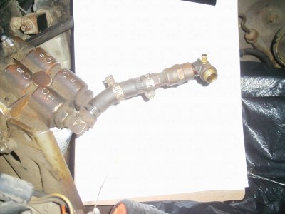

OK, I have about one inch of rubber line coming out of the filter head, this goes rearward, then there is a 90 degree metal "L" that the left of this line fits to, is this a compression fitting? Does this sound like it is stock? I realize things can be changed in 27 years, is there a rubber (olive/o ring) at the left end of the steel line I pictured that I need to change?
johneich
John, 1983 F250
Jan 6, 2011
474
Southern Illinois
Here is my filter head, rubber line & 90 degree metal "L", my question is, do I need a rubber grommet at the "L" to connect it to the left end of the steel line I pictured in my first post?
That thing looks jacked up! :eek:
An air leak waiting to happen, I know you can replace the whole line with a metal flex hose, but I don't know all the details about it.
That sure doesn't look factory to me.
I would clean it up by just going rubber all the way. :)
