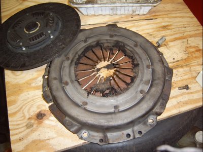

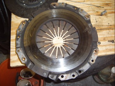

So were working on Droopy the plow truck, (88 F250 reg cab 4x4 5 speed 5.0) I knew that it had a weak clutch when I got it but have been milking it along till now. We decided to get it replaced as we may have some serous snow coming in the next week or so.
The truck is a one owner truck and had been sitting for quite a while before I bought it, because of a fuel system issue.

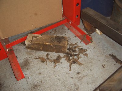

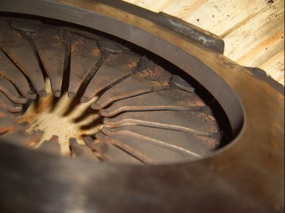

Apparently since it had been sitting, an mouse built a nest in the clutch area, and all of the stuffing from the nest became lodged between the clutch and flex plate while driving it. Thus allowing the clutch to slip.
Here are some pics, There is also a pic of the nest that we dug out of the clutch, pretty wierd hu,....?
