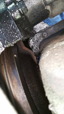

I don't think I have a dmf? I'm really not sure. It's never sounded like this before the pump and injectors and ic install, it's always had the same amount of gear overrun. I'll try retarding it then advancing it each tank and go by Max fuel mileage.
Can too little advance cause knocking?

So you running 13psi with no intercooler. I am thinking with an intercooler I should be able to run more advanced.
Listening again to it this morning it can best be described as a cold diesel knock. What causes cold diesels to knock or clack louder when cold? Retarded detonation because of cold air? I'd say for the half second it sounds like a 6.0l cold starting
