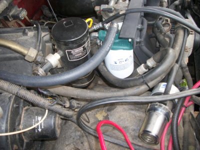

yeah thats the one.you can get it from Doug here,just with the Carrier Transicold brand name.same pump.
well no,you don't pull power from the FSS.you pull it directly from the battery,but can use the FSS to open a relay between the bat/pump.this is how i did it.
the pump turns on and stays running when you turn the key froward.
sounds like you just want to put it on a toggle though for just priming.
you don't need to mess around trying to get it mounted upright imho.
that's just if you need the advertized max pressures.
we need like all of 3 lbs under load haha.least thats what stock lift pumps provide at best.so im not worried about a possible drop to 7 or 8 by mounting it laying down(which i doubt it even drops that much.i dunno though.no pressure gauge.);)
they're made for pulling,so you can mount them up out of the way.rated for diesel fuel,and have a built in pre-screen filter so you don't need the hassle of installing a pre-filter.
pretty dang hard pump to beat for our applications.rated way over what we need for pressure,but im getting no ill effects or anything,nor has anyone else.
its the way to go.just don't try 'em for WMO or other thick fuels and it should outlast our trucks.
