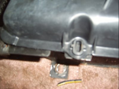

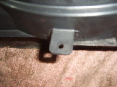

There is a tab on the side of the fan that is not used, Trim it off, shorten it up and bolt it to the bottom left side of the fan shroud. The bottom right of the fan shroud already has a tab on it that is long enough to use for the feet. If you add one to the left side, you will have 2 tabs that will nicely slide into the bottom of the radiator. The fit is snug but not too tight.

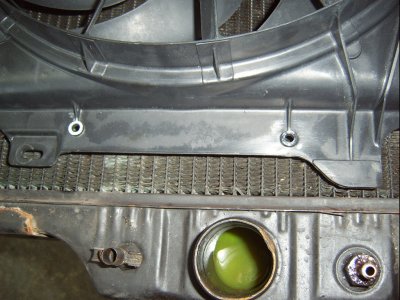

Next, you can easily bolt each fan to each side of the radiator shown here:
