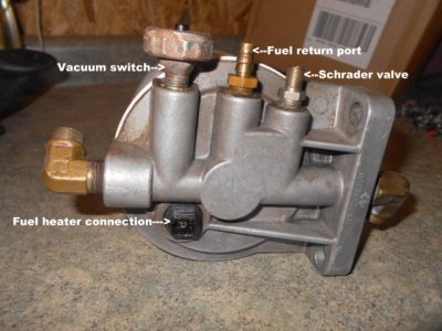

3. What thread size is the fitting on the 7.3L fuel filter head (side of the fitting that the hardline from the mech pump connects to)? For some reason I belive it's a flared fitting, like AN or SAE (same thing?).

The fitting on the side of the filter (lift pump to filter) is a 90* inverted flare 1/4" NPTM. The other side is the same (filter to IP).
You have to remove the fitting on the filter head, there is no other place to put a barb fitting. You could remove the fitting from filter to lift pump, replace it with a street ell and screw a barb fitting into the ell so that it faces down. The 90* ell in the pic is a 1/4" NPT, pic is of the fitting on top of the IP with the check valve still attached to it.
Link is for all kinds of fittings.

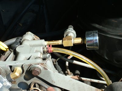

I removed and replaced the original intake fitting on the filter when I installed my Duralift pump. I replaced it with a single piece 90* ell, barbed intake end. This works well for me. You can see it in the lower left corner of the picture.
