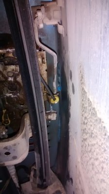

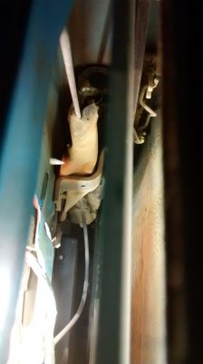

SUCCESS....(with pics too)
First pic, looking in the from the top.
Second pic, this is looking at door panel and how far its open.
Door's open, woo hoo, notice door panel sticking open. Didn't have to break the door panel,.....Bonus.;Sweet
Bottom left pic.
Ok heres where I can explain, hopefully, what I think happened.
Below the round yellow piece, is part of the locking mechanism, the door opened when I pushed this down all the way.
What I can guess is the power lock did not disengage the latch all the way, lock was partially engaged:dunno so when I closed the door it messed up.:dunno
So now the door opens and closes normally, but haven't tried the power lock yet, and yes the door panel will stay off for a while.
