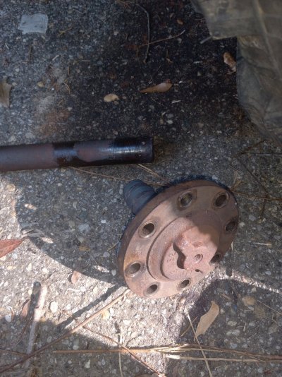

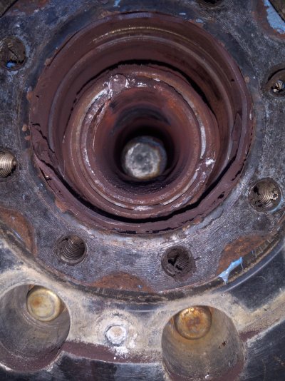

I have seen this to, most of the bolts were loose and fell out and the remaining few eventually sheared off. The way the axle fits into the end of the hub on the 10.25, this can happen without leaking any oil...
Have seen rusted axles to the point of failure, at splines or just in the shaft itself. Have also seen loose wheel bearings cause extreme axle spline/side gear wear.

Everything (bolts, pin, gears) seem good. Just found out that the guy I got the truck from had to have the driver side bearings replaced because the axle tried to walk out due to bearing failure. Will be pulling axle tomorrow.
