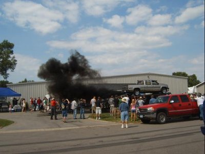

Here are a few more pics, Scotty and Dave have the pics on the dyno run so I have to wait for those.
The Tan Chevy on the Dyno is Nasty Girl, He hit 1070 HP! and the estimated 1900 torque. The dyno only goes to 1500.
