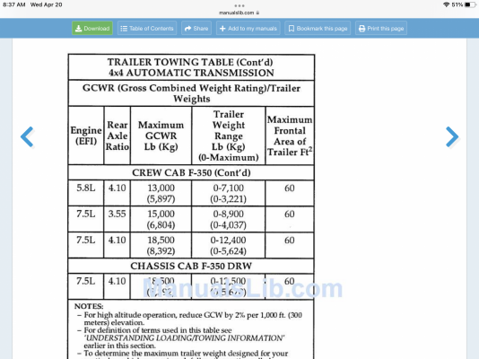

Your 11,000 GVW is total maximum loaded weight for your truck. Your truck probably has a curb weight of around 7,000 (you need to weigh it) so your carrying capacity would be 4,000. The GCVR is 16,000 with 3.55 gears and 20,000 with 4.10 gears. If your truck is loaded to capacity of 11,000 your trailer can weigh 9,000. If your truck is unloaded and weighs 7,000 your trailer can weigh 13,000. Both of these are based on 4.10 gears And automatic transmission. Hope this helps.

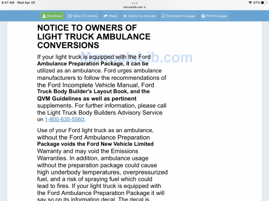

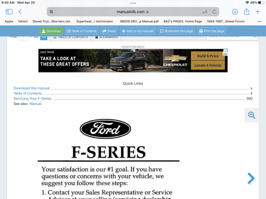

If you can find a 1989 owners manual it may have the information. I found this manual online. it doesn‘t say 1989
though.

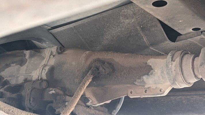

I wonder if this is similar to ambulance prep. Look at the metal heat shielding above the C6 on my RV.
