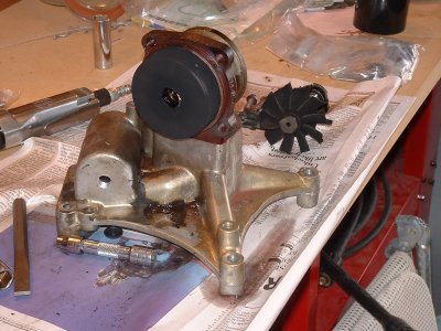

got under the hood and defeated that EBPV last night.
first i checked for range of motion. the travel was very sticky and jammed midway between open and closed. in the process of excercising it, fumbling blind, i popped the clip that holds the actuator rod onto the linkage, off. no luck getting that back together. i have long skinny arms but big hands and both just dont fit at the same time under the turbo.
That thing is a huge PITA to hook back up. The only problem you might encounter with the rod just hanging there is an oil leak around the actuator. Mine was good for awhile but then developed a leak. I gutted the butterfly out of the throat and pulled the actuator out and tapped the hole and threaded in a pipe plug.
i cut the actuater housing off my pedistal and removed the electric solenoid for it as well.i had all the holes welded up so no more leaks in that area for me :D
you aint kiddin. one thing i learned is the turbo has to come off for me to properly complete this project. i'll be threading and plugging the hole as well. i hope it holds out for a while like yours did before it leaks. how bad of a leak can i expect when it does leak. it's not going to puke all of a sudden is it, i'm envisioning seepage of a few drips.

Mine lasted a few months before it bagan leaking Rob, then what I would notice is a pie tin size puddle when I would park it. I assume it was filling the valley and then would run out the back hole when I shut her down. It was a good enough leak that I hooked the rod back up until I could do the gut job.
