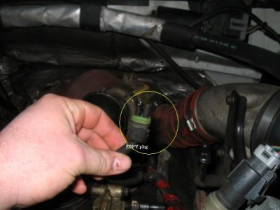

i still have to do a proper search but if somweone wants to point me to how to disconnect the ebpv i'd appreciate it.

thanks a million for the links.
what is that linkage thing on the turbo that has a rod attached to a vacuum actuator? is this the ebpv or the wastegate? this is visible on top of the turbo

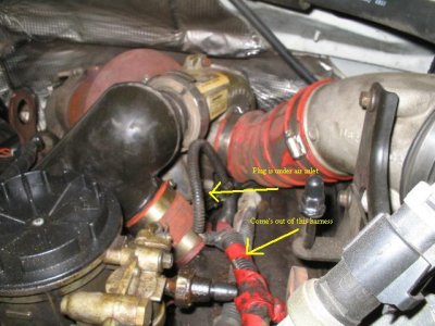

Rob here's a couple of pics of mine.
You're welcome Rob...........That is the waste gate.
If you decide to plug the hole in the pedestal to stop or prevent it from leaking, don't just completely remove the valve in there or you will lose oil to lube the turbo and eventually have the turbo fail. Just cut the shaft as shown in the second link and put it back together.
