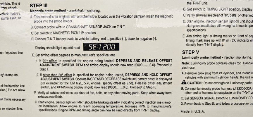

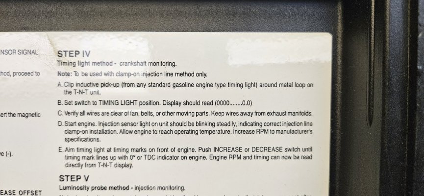

If you're not sure yet....
You need to advance the gun the 20 degree offset. Make sense?
Turn the knob, push the advance button till you get 20 degrees...

@Clb, to whom you're writing? I don't know why those 20*? is that the point at which our engine needs to be injected?

To you
It's been a *****:Whatever: C O O N S age, but when I got the 88, I borrowed a snap on ? Timing meter from a friend and seem to recall setting up the advance to 20 degrees...
Here is the information on a j33300-A kent moore

Ok, Thanks.
I think now I need to go and buy a new timing light.
Mine doesn't have the variable button.
