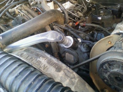

heres how i did mine for 10 bucks. to block the hole in the intake and the valley pan i used ruber freeze plugs
Interesting routing with your RDT... Have you ever worried about the spots where your tube seems to crimp slightly?
all i did was take my oil fill cap off and put a plastic guy that treaded onon end and barbed for a 1 inch hose
its a 1 inch hose and i can see a smoke haze idling at red lights when its warmed up so i thinks works real good
