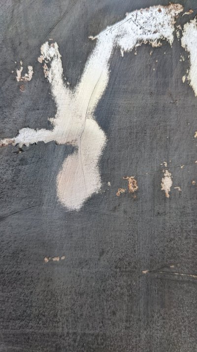

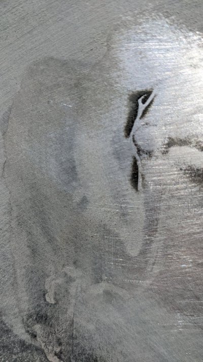

The fuel tank I bought off a guy from marketplace started leaking bad. Pulled it out and found several small cracks on the bottom and back.
Would a fuel tank sealer work y'all think? Any recommendations? I don't have a welder.

You can jb weld it and then get some stuff called "red kote" and slosh it around on the inside. I've done that to several tractors and almost was going to do it to my tow trucks tank but my junkyard buddy had a good tank that I bought. But really "red kote" is some "show nuff" sealer.

Already tried the JB weld and it didn't work. I may try that stuff if it'll work. I paid $400 for the tank and after 4 months this happened. I don't understand how it happened very peculiar and it cracked in 4/5 spots.

The jb weld is to stop the red kote from leaking before it seals. Red kote boasts that it will fill an 1/8in hole without any help. I've used it on some pretty nasty tractor tanks.

I had a Farmall C and an Oliver. The tanks were really rusty. I set the Farmall on jack stands, filled the tanks with a couple pounds of roofing nails, ratchet straped the tanks to the wheels, cranked the tractor up using a lawnmower gas tank temporarily, and let the tractor run and tumble the tanks to get all the rust loose. Washed the tanks, prepped them, and red koted them.

can you braze?
if not, try silver solder with a good acid flux
you can get a little kit on amazon for 20 or 30 bucks
rinse and flush well if it had gas, I soldered diesel tank by just draining
don't blow up

I'll look into that. Thanks for the information.
