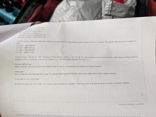

I thought this was interesting... from the AERA bulletin for the 7.3/6.9 pertaining to injection lines.
"Injection lines - Due to the .060" retraction of the injector nozzle on the 7.3, all 7.3 injector lines have been shortened by .060" However, all lines with the exception of #1 on F series, and #4 on E series, are interchangeable between 6.9 and 7.3."
