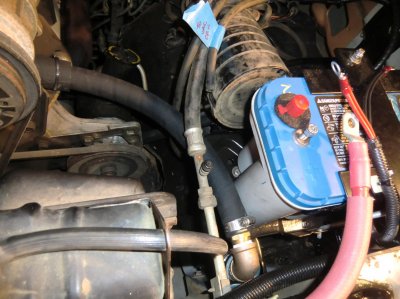

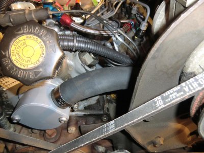

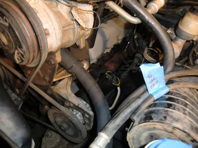

I'm going to run a road draft tube using the Banks adapter that fits infront of the oil fill. I just finished the install of that tonight (pict attached).
But, I was thinking of running a bypass filter (Amsoil or Filtration Solutions) with a return to the oil filler cap. But, with all the crankcase pressure venting out right in front of the oil filler, do you think I will lose oil out the RDT?

Archie, I have my RDT running exactly the same way that you have your system routed. Adding a filter though seems like a bad idea as it will eventually plug up with oil mist and start pressurizing the crankcase. Hell, I had a small single square of plain steel wool over the end my RDT to keep mice out while my truck was sitting (hadn't been driven with the new RDT yet). I forgot to take it off when I drove to town for fuel, sure enough it had plugged and pressurized my crankcase enough to force BOTH valve covers to leak as well as my oil pan. Thus, I advise against it. Not only that, but it does not reduce the amount of visible blowby.
