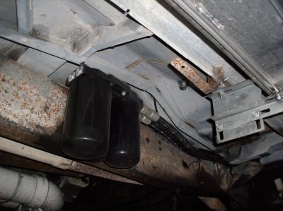

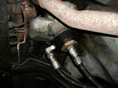

Hey Archie,
If you're thinking about the Amsoil system, then I would say go for it- definitely easier than the options so far presented. Get Amsoil's in & out adapter that screws onto the stock oil filter mount- this will save a sh!tload of work and is bullet proof. Take a look- I love mine & the filters are easy to change also...;Sweet
