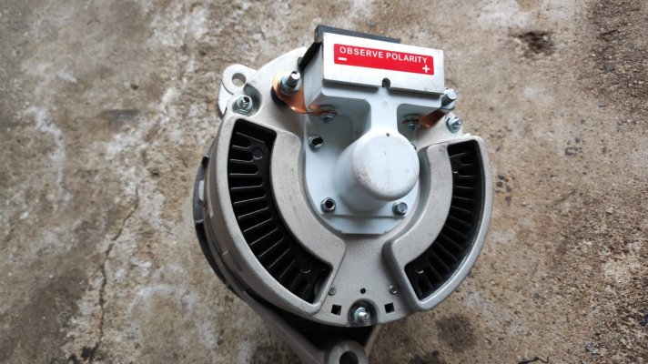

Hi @ all,
must this copper plate be attached to the both of the negative terminals?
On the "1." new one there was a copper plate to the both negative ones and the both positive ones.
On the 2. new one there was only one on the positive ones. So I did NOT change this.
derjackistweg
Jul 29, 2013
196
13
Cologne/Germany
Hi @ all,
So, I guess the missing copper plate on both sides, plus and minus, are critical.
I later put on the plate on the neg pole/to neg. on the regulator side .... and it works now!
And it works now like it is supposed to be: Stable 13,8 or so to 14.2V.
No jumping no nothing.
So looks like the regular on the new alternator was false. DOA.
