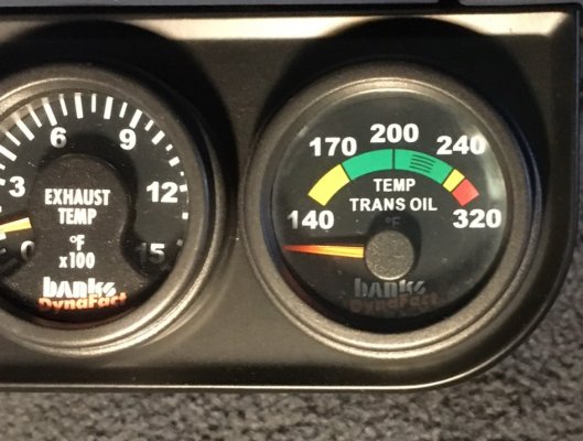

The green band on my F250 4 x 4 Banks transmission temperature gauge starts at 170 and goes to 240, yellow starts at 240. Yellow is from 240- 260, then red. Top of red is 320.The Banks gauge sensor is on the hot fluid line from the transmission to the radiator. Fluid then goes to the auxiliary cooler in front of the condenser and back to the transmission.
Summer of 2020 coming across the desert from CA to AZ with 1,000 pounds in the bed, air conditioning full blast cold, 109 degrees at Needles, transmission temperature climbed on every long grade to the top of the green but not into yellow. Hit 6,000 feet a couple of times still 100 out.
