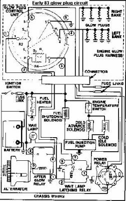

Here is the 6.9 early GPC, the one that screws into the pass side head.
