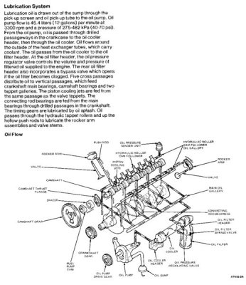

do you have a picture of the oil passages? tried looking and struck out on the 5th swing.
I have heard the issue isn't with the bottom of bottom end, it has more to do with block flex, or coolant pressure popping out freeze plugs?
I love these IDI's but its old technology. kinda like trying to run **** on a flathead v-8... it can be done... but its not for the faint of heart.
Not talking about the oil passages. Coolant would not flow to the cooler if the bottom is filled. I know someone here has the flow path of both oil and coolant

Here's the water.
Looks like the oil diagram below it but I don't seem to have it handy.
338
Oil screen on the pump pickup is 3/8" from bottom of pan.
