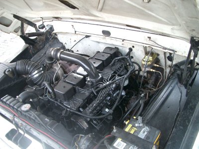

Put some big injectors in it, then you'll see some REAL black smoke! I'd be suspecting the pickup in the tank, the lift pump on the 12valves rarely go bad(but still do). Any pictures you'd like to share? Always good to see a swap!

my truck
here is my truck
