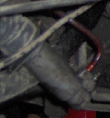

For what it's worth, a guy from the TDS days that I knew (jaluhn if anyone remembers him) found out that CarQuest carries a replacement slave cylinder for our trucks, that has a metal housing and a bleeder port with a nipple on it. I bought one when my slave cylinder failed, and it's been working quite well over the last 6 years or so/
Here are a couple of pictures of it. Sorry the quality isn't that good; these pics were taken during my tranny swap in '05 (which explains why it's dangling out of the way :angel: ), and the slave cylinder wasn't really the subject of the pictures; it just happened to get in on the edge and I cropped the rest of the picture out for this.
