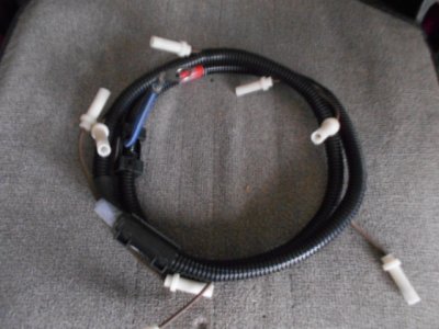

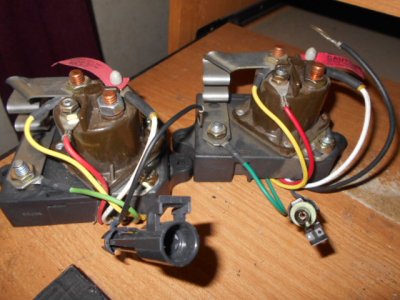

338
I have a new controller and new harness. The harness is for an IH 7.3, but I remove the two extra wires in them. PM me if interested for price and shipping.
You have a PM coming your way. I have to say you are one of the nicest and most helpful person on this site!! Thank you so much.
