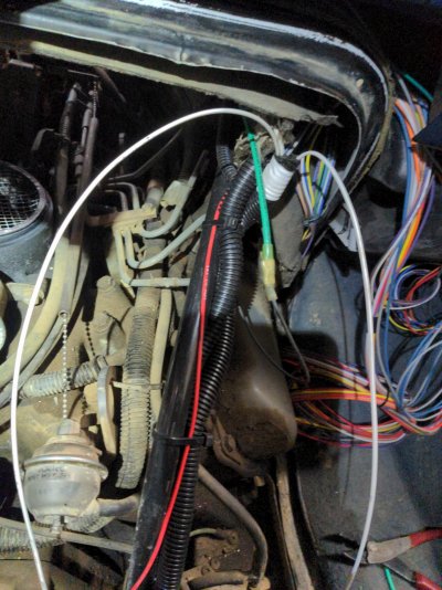

I ran all the cables except the single green speedo wire through a rubber grommet in a hole I drilled in the firewall(?), high on the passenger side, immediately in front of the removable doghouse cover.
From the engine side:
From the cab:
