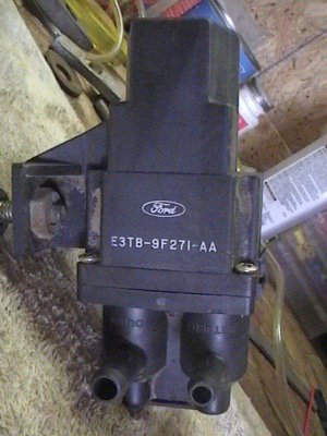

Just tried it direct, using a jump box. It flipped to rear, then to front, rear, front, about five times. Then it flipped to rear, but wouldn't flip back to front until I rapped on it with a hammer again. It'll flip to front on its own about 25% of the time. Rest of the time, it'll flip, but it takes just a slight rap. So I don't think it's the switch.

Well now you know 100% its an internal FSV fault. Last chance for it may be to look up the disassembly/cleaning thread.

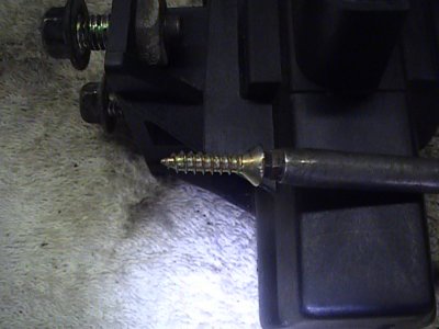

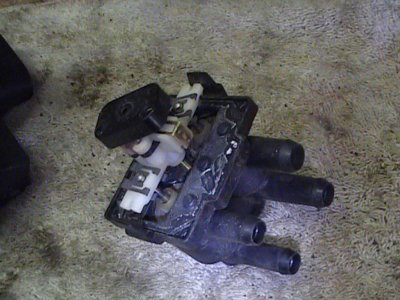

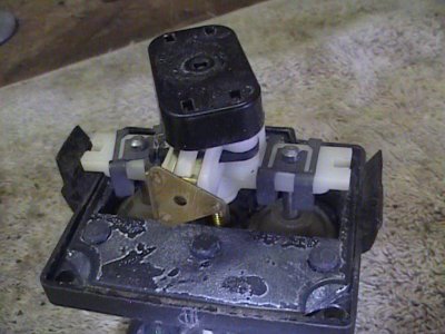

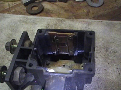

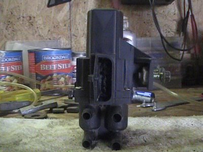

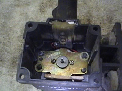

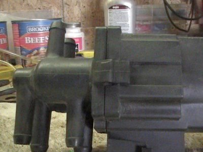

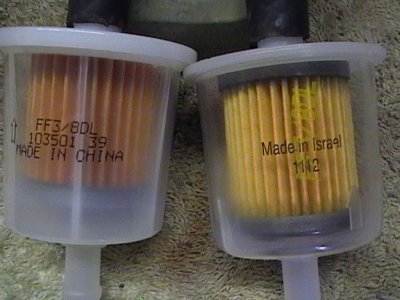

338
FSV tear down. Drill out the 4 rivets, just the crimped part, punch out the rivet's. The pic with the screw is what I used to go back together, just drill out one half for screws to pass thru. Added the filters on the suction side. When apart, you'll see how the slide switching operates.
