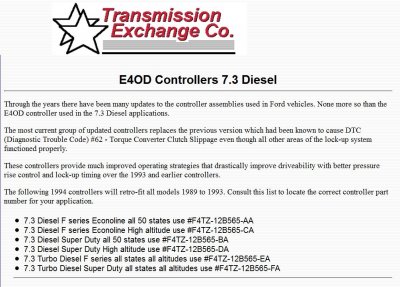

the updated/latter TECA's wont do this.she'll hold onto 3rd or 4th.no hunting.you could always update.though pressing the od button is free.:D
attachment.php
