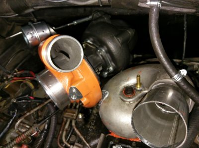

I looked at a ton of stuff. Nothing was going to work no matter how I clocked it. So I made this.
Had to loose the air cleaner bolt to get down low enough.

Ooo that would work too. Do you screw it straight into the intake manifold, where the screen hold down was?
Gonna order that carb cap and see how much surgery is Required. I think an angled cut on the turbo facing side and then an elbow or stub of pipe ought do it. If I can mock it up, I'll get in touch with our TIG capable board brothers.
Till then, it's a bolt-up 3" intake with a hacked up banks box.

Yes. It's a 5/8 UNC thread if you take the screen out. I could probably put it back on but I'd loose some compression of the oring. I'm not sure it's still perfectly flat after the welding so more squish is better.
I've still got more finish work to do on it and I'll cut the tube to length and bead it once I get the IC plumbing together.
