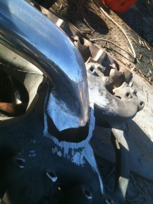

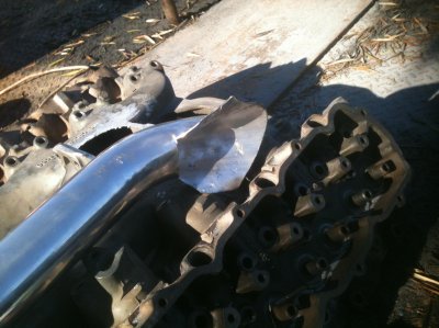

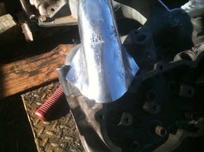

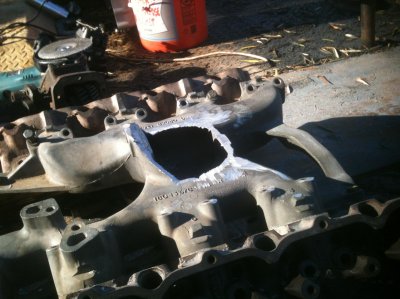

Don't seem to have a picture of the final result somehow but you get the idea...
