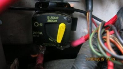

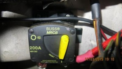

I too ended up purchasing a one-wire alternator from DB Electric, but because I am running V-belts, this was the model that I purchased:
http://dbelectrical.com/p-4713-new-ford-truck-car-220-amp-high-output-alternator-1965-1992-7749.aspx
As someone else said, the alternator needs to see some rpm before the residual magnetism will energize the field and to start charging. I have read that it may be possible to connect a switched hot source to the the green wire on the alternator connector (will require a new connector) to flash the field immediately so that the alternator will start charging at lower rpm. This may also fix the issue with the alternator warning light not working. I have been able to get DB Electric to answer these questions, and don't want to "just try it" and fry the regulator. If anyone knows these answers, it would be greatly appreciated.
On a side note, rather than use the fuse setpoint supplied wit the alternator, i went with a marine type 200 amp circuit breaker. This is a bit below the 225 amp rated output of the alternator. I was able to mount it in the location of the original voltage regulator. (see photos)
