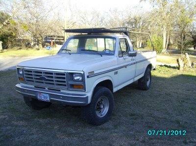

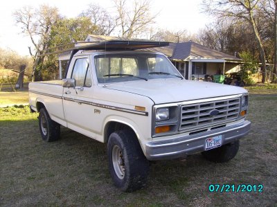

looking for a diesel by any chance? I have this one sitting in Hamilton(3.5hr north of you).

I really wanted a 1993 Gasser, but after a long hard think, I have decided I should hold off on buying a truck, mainly because I'd be broke after doing it, but also because I just bought a car this month and have to save up again. But that is such a beauty.
