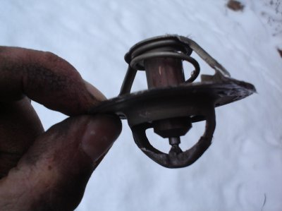

I have attached a pic of the t-stat that was in the truck, just pulled it out. Doesn't look anything close to the motorcraft one nor the stant. Anyways as I explained I couldn't get the motorcraft t-stat today so I had to settle for the Stant for now and I will put the motorcraft in next week when they re-open. The truck is running cooler now but still a little hot. The gauge sits right in the middle when cruising down the highway and climbs going up hills and a little when idilng. It was a 190 degree t-stat.
I have always seens these factory temp gauges sitting at about a 1/4 on the slatnose rigs. I know I shouldn't be going by the gauge but its all I have for now and it is in fact moving and giving an indication of whats happening.
Do the motorcraft ones run cooler yet? if so, that would likely cure this issue once I get my hands on one.

The factory IH/Ford thermostat is 195*
My '87 E350 motorhome (uses the same dash electronics as the 80-86 trucks) sits right in the middle with a IH 180* t-stat. And use to sit on the A-L of NORMAL with the 195* one.
I do have a real gauge to confirm I am running 180* while the dash gauge reads in the middle on the R-M.
My other van, an '85 E350 runs on the O fully warmed up, and most likely has the original t-stat in it witch is a 195*
So theres no real telling what's your temps just by these gauges, they're all different!
That t-stat you pulled out does look like an aftermarket one, witch is NOT recommended to use in these engines! Any aftermarket brand WILL NOT WORK right in these engines.
Use IH or Ford only thermostats.

Yup the temps climbed a bit when I had it idling after I went for a test drive. Could very well have been a PSD stat; the parts stores around here think every Ford diesel is a PSDcookoo The stant looks like the motorcraft.
IDIdieseljohn, what port did you install your aftermarket gauge in? The engine overtemp port in front of the drivers side exhaust manifold? I would like to put mine in the same spot when I get to it so we can compare readings. It is reassuring to hear that your factory gauge sits fairly high also yet the real temp is 180.
PS I did a boil test with the t-stats in a pot of water and had the stove on medium and observed them slowly open up. They opened at the same time but the old one that was in there closed sooner than the Stant. Id like to get that IH 180 stat that ididieseljohn mentioned...

if that t-stat that you took a pic of was in your truck then it is not a psd stat. there is no chance in he!! that the psd stat will fit in the idi. i found that out the hard way.
