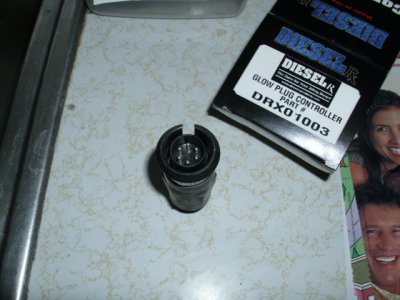

So, how many pins are in the new one? I simply ask because I was just trying to compare it to one I have sitting in front of me. Thanks!

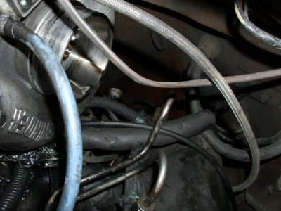

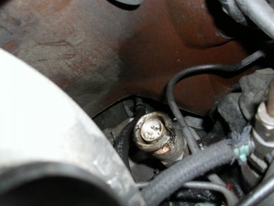

We just used an open end wrench to change it. Granted, the angle is not the best, but then you don't have to do that much tightening either.
Interesting. Yours has the same number of pins. Maybe they figured out people would freak if the number wasn't the same.

Doesn't take me any longer to get the air cleaner off in the vans than it took me in my F250.
Just a lil less room to shove your hand in there, and twist the wing nut with your finger tips.
