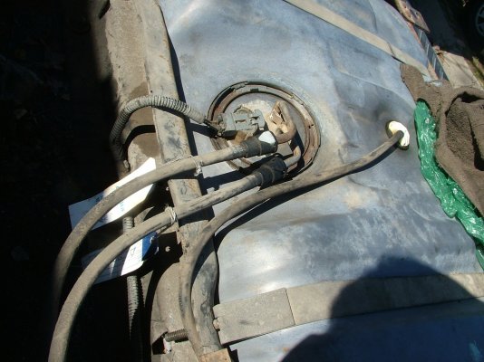

Just for S&Gs I'll attach a picture of my rear tank. The white thing in the middle of the tank, with a single hose attached, is a vent. There is a similar vent on the front tank.

Thanks. Would you happen to know where the vent hoses end up so I can check that they're functioning?
Edit: Sorry. I should check the Tech Article before bothering you. Will do.

The hose I showed, for the rear tank, goes toward the driver's side. You can see it clipped to the crossmember at the very bottom of the picture. It doesn't go far, so once you find a part of it, just follow it a couple of feet. At least that's the way it is on my truck.
