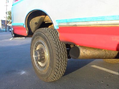

if I were you, I'd quit screwing around hunting for pieces and buy the kit. You've seen the muffer on my carrier, it's a 4" straight thru and the part alone set me back $125. Install was another $30. Three key items in the kit...one, the tailpipe bends have already been worked out. You are going to waste alot of time trying to reinvent the wheel there. Two. the muffler. Its a straight thru design. Three. the adaptor pipe from your 3" DP to the 5". On the OBS trucks, the exhaust system is just like ours so there is almost no wasted parts as a result. Buy it. put it in. And be done with it. I got 4" on mime right now and the decel rap is gonna get me a ticket soon. Prolly will buy that kit too when time allows for me to be near the shop to wait for the ship.
added in edit.....
here's a pic of the pipe Tim was talking about.....
