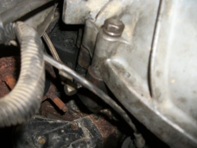

here is a pic of the pass side.i had to flake off the paint first.
both freeze plugs are as smooth as a babies bottom.they are indented but there is no secondary dimple nor nipple in the center.

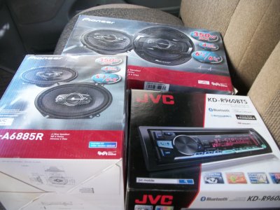

here are the new goods to bring her tunes up into the modern age:
(oh.don't recognize that tan seat? i grabbed this off color super cab,split back,bench seat off CL a year or so ago,because the original gray was broken down and rode hard. a $40 special!)
attachment.php

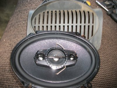

so i rip both rear paper speakers out:
attachment.php
attachment.php
and in with the new 6x8's baby:
attachment.php
attachment.php
fit just like oem and look no different once installed.....but oh do they sure sound much nicer.;)

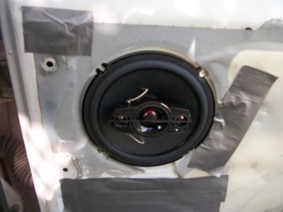

so i remove the door panel and rip out the old paper speakers.i dunno who remembers but once again you can see her original white color:
attachment.php
here are the new fronts:
attachment.php
installed with a couple self tappers with the cordless:
attachment.php
door panel back on,and repeat the process for the other side:
attachment.php

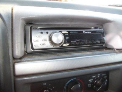

now it's time to drop in the new head unit
(don't mess with setting it up too much,as im just going to disconnect the battery again anyway,as her starter is still out)
and then it's time to crank up some DIO and test her out!:rock:
attachment.php

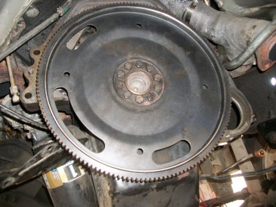

new flexplate installed with bolts torqued to 47 ft lbs.
attachment.php
so when installing a flexplate,you cant install it wrong because there is one bolt hole that doesn't have threads.so you know to cover this one up with the only blocked off spot on the flexplate so the rest of the holes accept bolts.so you can't frig up the balance.

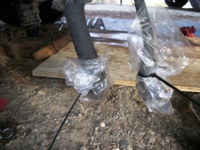

so after lunch i continue on.now where did i place that last bell housing bolt? oh well......dropping a transmission is dirty work.dirty has no place when talking about electronic controls.so this is how i keep her connections clean during removal;
attachment.php

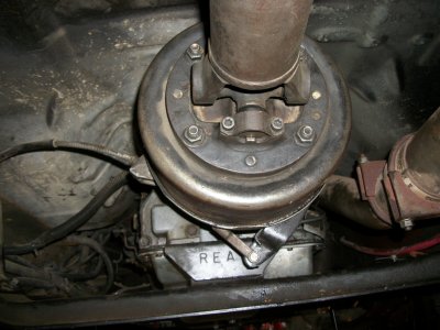

getting close now baby! just need to hook her drive shaft back up!......and find that gosh dang missing SOB bell housing bolt! where the heck did i put that? oh well.......so close now,i can taste it! i'll find that bolt when i back her up a bit..
attachment.php
attachment.php
