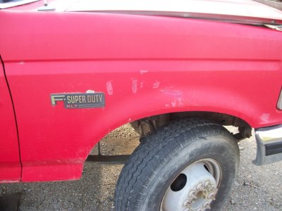

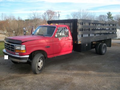

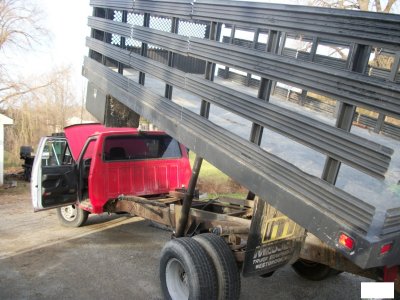

new to me rig!this is not a replacement truck.my chip truck will always be my main/go to/multi purpose truck.below will be for hauling logs and or larger jobs to save fuel and time.
this is: "Log Truck" 1993 Ford F-Super Duty XLT
she's a long wheel based F-super Duty (f450) 2wd hd beast with XLT trim, a 16' stake body dump and some underbody boxes.another old school legendary 7.3l IDI with the E40D.another N/A engine,but with her 5.13 gearing she'll do just fine as is.it's like she gets up to 25mph and she's all done shifting lol! very solid truck! surface rust only.never run winters.189k miles.properly maintained w/ sca's.

681
Thats a nice clean rig. Sure is easy to reach any of the fuel tank senders too. nothing easier that a lift bed rig for getting at the tank senders...:thumbsup:

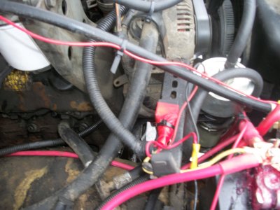

new batteries,new battery cables,mechanical pump delete,dura lift e-pump and coolant filtration.
she starts like a new one now.
look at that paint eaten away from the valve cover on this side.this was due to the fuel heater port leaking.the heater didn't work (i didn't feel it getting warm at all) but they had the wire still plugged in so it was smoking! good thing it wasn't gas,she would have probably burned down.:D

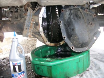

rear diff flush.......oh man.stinky.i wonder if it's ever been changed.looks like it cus two bolts were replacements with washers (nothing stripped out though) but i bet it's been awhile.bottle of the stuff going in.
