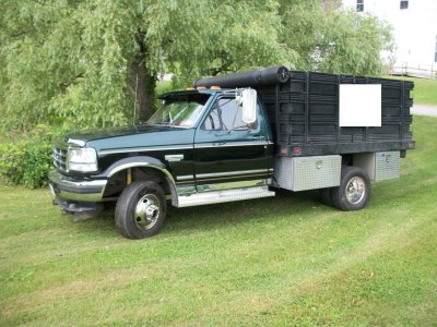

1993 Ford F-Super Duty XLT - "Log Truck" (new to me truck-pic heavy)

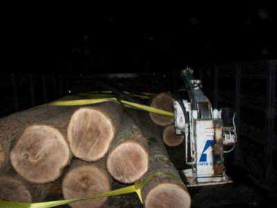

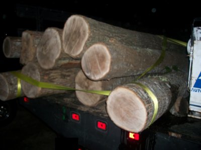

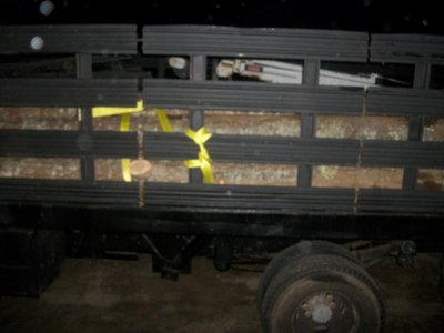

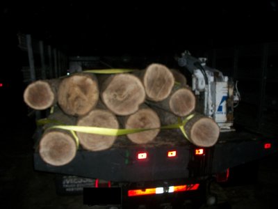

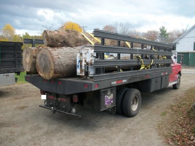

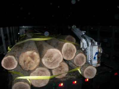

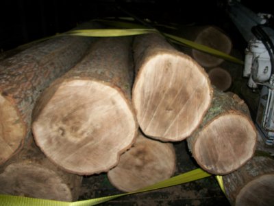

tonight on log truck..............log truck lives up to her name with her first log load.a dozen red oak logs.
8 @ 16' + 1 @ 14' + (in front of the crane) 2 @ 8' + 1 @ 10'

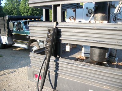

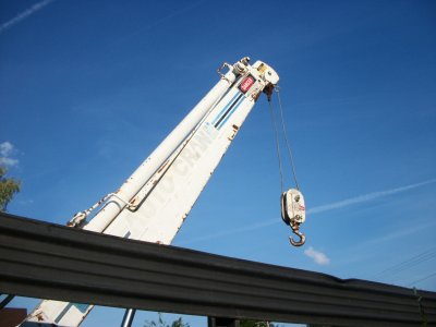

however,the hydraulic system on the crane isn't working properly (the seller informed me and we renegotiated the price so i got the crane at a real bargain)
the controller (pendant) or solenoids/wiring and or the hydraulic motors may be worn out.
for example on the electric side of things.you can't just lift the boom without also swinging it at the same time,or you'll just here a solenoid click.same goes for extending it.you can't just extend solely.need to swing back and forth to make in go out or in.it will lower on the single command however.when it does raise it had good power.feels full and strong.the swing power to swing the log into the bed however is very,very weak.the cable in/out works properly (full electric winch part,which made loading possible for now) so she needs some diagnostic work.but holy crap,it works well enough for now to now that once fully functional,it's going to be just the ticket.

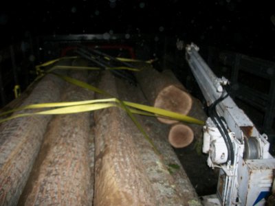

iv got a few monster spruce logs i saved and put aside on a large job back a month or so to break it in.some nice very large diameter 16' monsters.
i finally went and got these before snowfall.some nice ones.she defiantly needs some outriggers! had to cut a short log and prop it up under the bed to load these.that worked really good actually.she was tipping the side really hard without it.

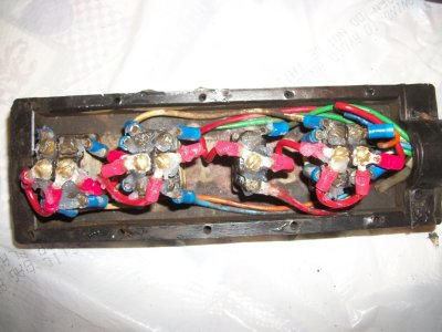

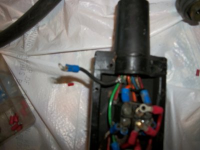

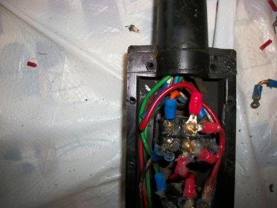

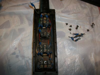

well when i bought it,the seller gave me a discount due to it not working correctly.well tonight after work and using the crane the last couple business days,i figured id finally take the time to see if i could resolve the issues with the crane.for a lot of the commands,you had to use two at a time or one wouldn't work alone.
for example,to extend the arm,you had to either lift or swing at the same time in order for the extend switch to work.so i grabbed the pendant and took it apart.......ahh there's the issue.a poorly done corroded ground connection where someone has been before,years ago and corrosion all along the way where each switch gets it's ground.EDIT: or power i didn't even test them lol! i just see what was obviously the issue.
attachment.php
attachment.php

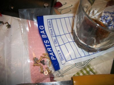

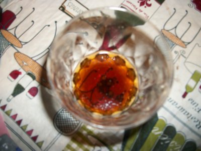

so i removed all the bolts and eyelets.cleaned up the contacts and set the bolts in some coke to remove the rust.....but this is the log truck show! who wants to sit around and watch rust dissipate from metal? that's no good here,
so off to the hardware store to grab some new ones and keep this show on air lol!
attachment.php
attachment.php
so i fix up the poor connection and because the small connecting bars were corroded and broke as i removed them,i simply made loops to connect the row all the way down the line.easy peasey,lemon squeezey.
attachment.php
attachment.php

We just went thru the same thing with one of our Ramseys - lousy contacts in the connector between the pendant cable and the relays housing, plus some nasty corrosion inside said housing where the power lead for the pendant is hooked up to the relays main feed bar. Couldn't even touch the feed bar nuts without complete winch removal, to heck with that, pendant power is now connected directly to the stud for the main battery cable. Good opportunity to install a 2nd control cable and run it inside the cab permanently, plus new wiring connectors and like you did dielectric grease everywhere, should be good and trouble-free for many years to come.
