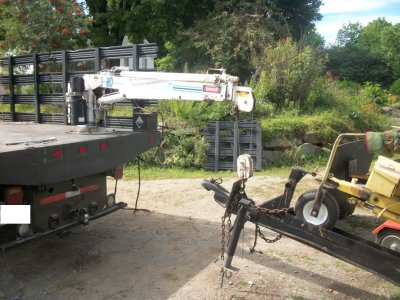

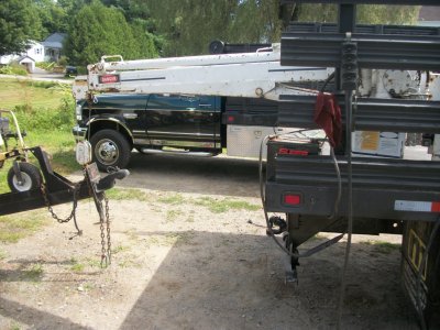

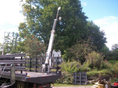

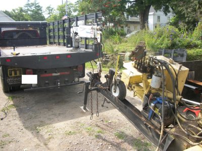

in today's episode of log truck.log truck can finally live up to it's name with the installation of the used auto crane 3203 prx.
so it's really pretty good but i think more reinforcement wouldn't hurt.i placed a 1/2 steel sheet below the decks c-channel and bolted down through.it could use another sheet up top but she feels really rugged right now.the only flex i see is the whole truck.no movement from base.
so for a complete hookup i'll bolt a 24" under body toolbox below the crane to house the battery and run a 10# wire over from the tow harnesses junction/hot bat charge.she's gunna be nice!;Sweet

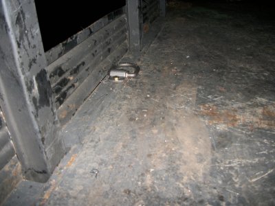

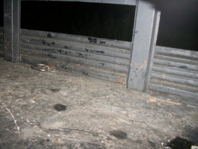

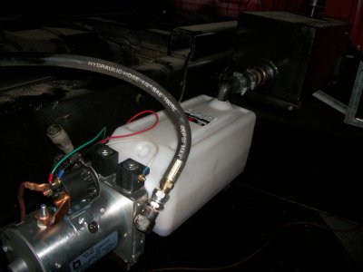

log truck double shot tonight here on channel 444!!! .........the outfitting saga continues.
tonight log truck becomes even more capable with a replacement dump pump.power up/down.Monarch 3551k (same as chip truck.)
just need to run a 1awg line w/ circuit breaker and top her up full of fluid.temporarily tested/working via old small wire the po used.
installed 6 tie down hooks (3 down each side) to strap down full length logs.
log truck is becoming much more capable this weekend.;Sweet

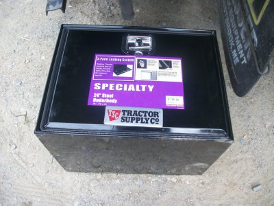

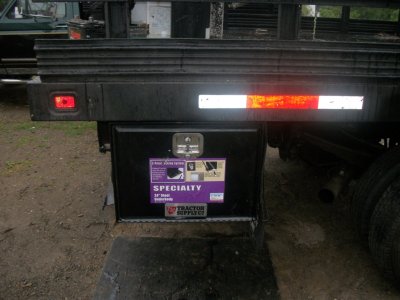

tonight on the log truck show.........the install of a 24" underbody toolbox that will be used to house the battery for the crane and future lift gate (if i ever get that installed lol)
i was gunna run a #10 battery charge over from the rear junction box to have that ready but then i got rained out.so need another rear bolt to finish mounting it also but she's pretty much good to go.this one will tip with the dump bed as the wires from the hydraulic devices will need to remain stationary.so i'll need to secure the battery inside so it can't slide around either.tractor supply has truck toolboxes 20% off this labor day weekend.;Really
