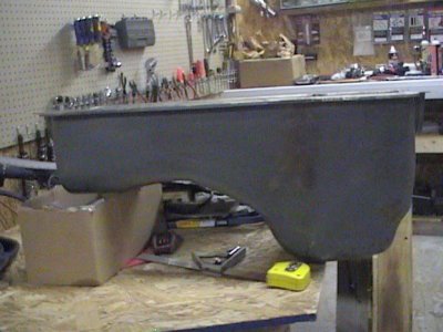

Going up and down hill is what's making the pressure fluctuate. To me that is the pick up tube has broken off or it's cracked. You can drain the oil and save it if relatively new, then stick something up the plug hole and see if you can move the pickup screen, if you can't get to the screen, then use something to see if you can move the tube, you should not be able to move it.

Look at the oil pan. The normal oil level is just below the pan to block joint. Very seldom do we have a pickup tube crack or break. They have a very good mounting setup. The pump is located at the front of the crank and is gear driven. then the suction tube runs all that way back and to about 1/8 inch from the bottom of the oil pan. you can see and feel it when you drain the oil. What oldbull posted about draining the oil and see if the pickup screen on the end of the suction is loose or gone. About half way back the suction tube has a nut holding it to a main bearing cap bolt.
