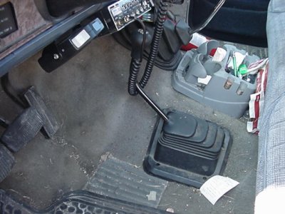

i have a zf and a 1356 in mine. the truck was a 2wd auto when i got it.here how it looks now. i know its dirty, carpet is coming out soon and the weather just broke so i can vacuum it now. the wife gets all up in a tizzy when i take her vacuum out in the snow:backoff:D

I think he's talking about the trans shifter. It does look like one from a T 19 being bent. Also looks like the T 19 shift boot as well no?
386
Spill the beans. You have a CHROME shift LEVER. THAT is what they are asking. LOL

Diesel4me2 hod dou you have the WTS lite on the left side of your steering colum? i would love to have a cubby like the gas trucks
