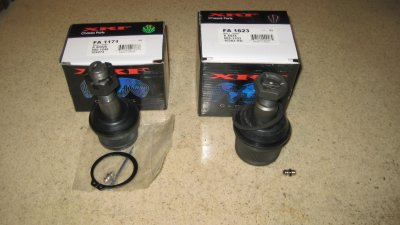

Got my XRF ball joints in the mail today. They look like.........well..........ball joints.
Have read on the net about them being real stiff, but I was able to crack them loose and move them around by hand. From what I remember, they feel about as stiff as the Moogs I had installed in the past.
I'll update my progress as I go. My truck is too damn long to fit in my garage (about 6 feet too long), so I'll start working on it outside, weather permitting.
