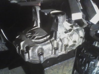

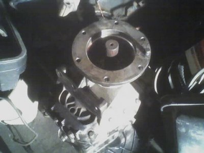

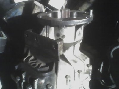

here's the pics of the 2ws vs 4wd ZF tails. pics are kewl;Sweet
