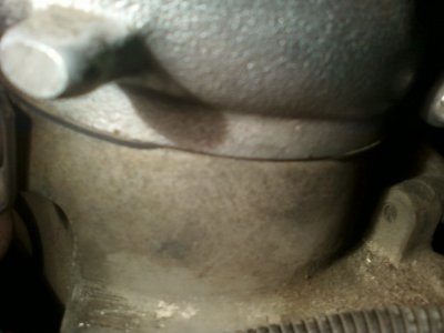

i found this when looking at my snail.
i am wondering if when i reach 5psi the o-ring kind of blows out creating a wastegate effect and dumping boost.

very possibly. If you've got a digi cam, mount it in there + light and put some suds there and go for a spin. record and see if you blow bubbles. My .02$ and guessing
682
That gasket in the picture is not leaking. If it was there would be oil around the leak. Remember the crd blows into the intake and mixes with the air charge.
